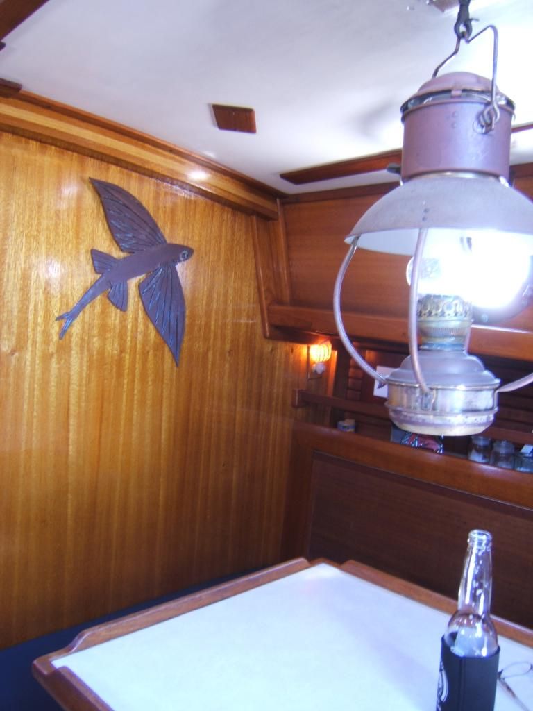

Hi Professor , and welcome to Sailnet . On our boat I painted the overhead ( made from ash ply ) with Interlux Brightsides , because ms.westi caught it on fire . Actually not her fault the propane stove blew up . Don't worry the boat turned out ok , but it took me a year to fix . The Interlux Brightsides is a single part paint , but you do need to thin a little bit . It has excellent gloss . Else where in the interior I use varnish and oil .
